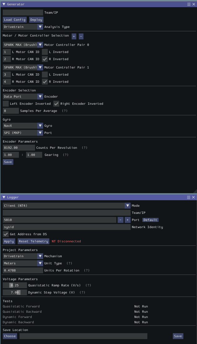

Hello, when my team runs our System identification for our drivetrain the dynamic tests don’t really follow what the example video on the docs shows. Our drivetrain setup is 4 spark maxes connected through CAN to 4 NEO motors with a NavX gyro. The back two spark maxes have REV through bore encoders connected to their data ports and the encoders connected to our gearbox’s output shaft.
During the quasistatic tests, it follows the example video, however when we try the dynamic tests the robot goes a bit jittery where the motors sound like they’re going back and forth. A different time we did the dynamic tests the robot would start turning to the left. Sadly I don’t have a video and don’t have the outputs of our tests to show and won’t be able to for a bit, but I can show what our config looks like.

Wouldn’t using the built in encoders for the NEOs changing my config to include the gear ratio?
I have no idea what your issue is, it is the weirdest SysID issue I have ever heard of. The built in encoder really would only change your results that you get back. The only other things I could think of would be physical issues like wiring or maybe you have some motor inverted incorrectly. If you want to calculate these constants there are other ways to do it.

I got the system identification to work by not using the REV through-bore encoders and just using the built-in encoders in the NEOs.
