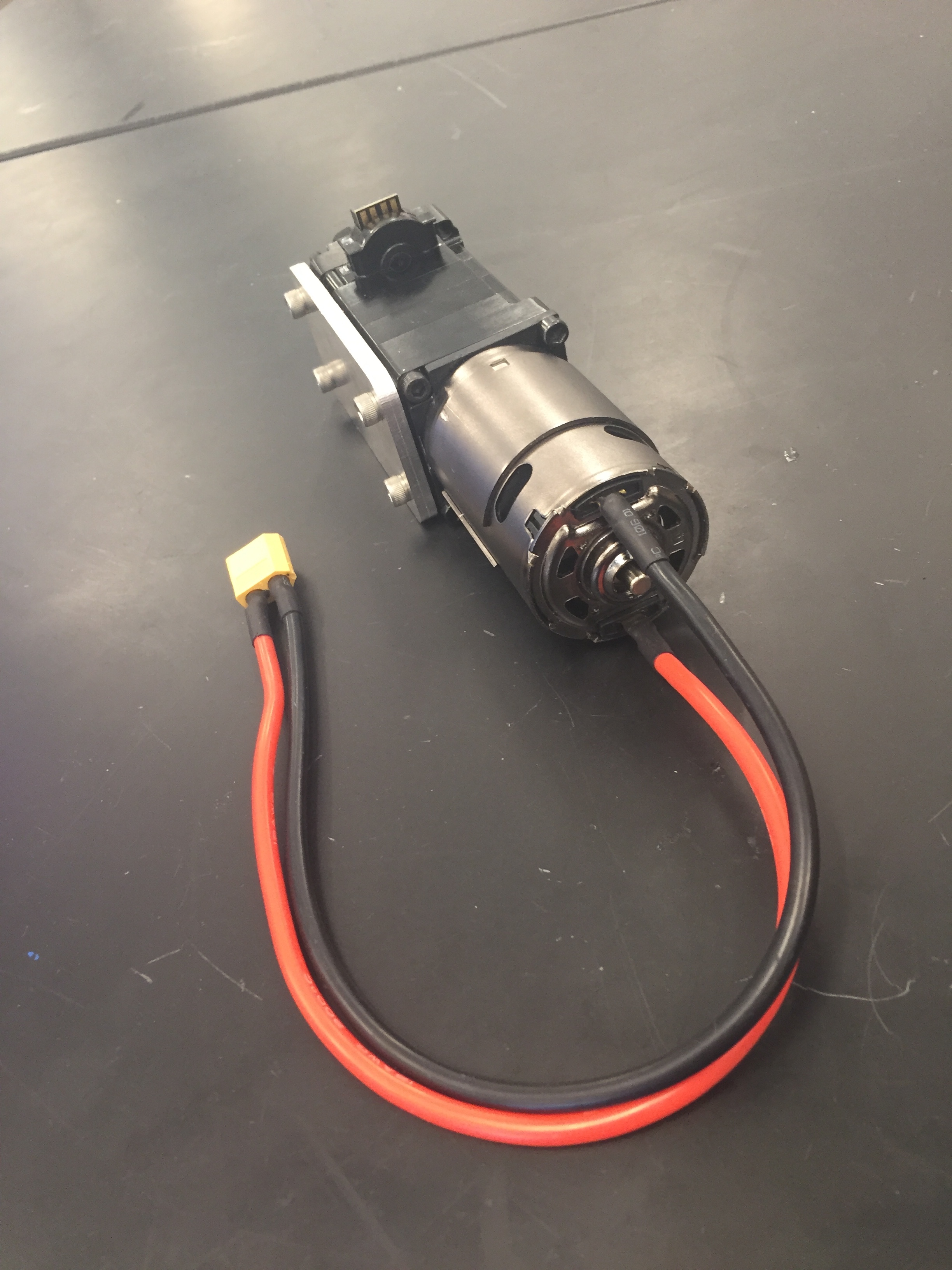

It’s extremely hard to determine exactly how much resistance force the inefficiency in a gearbox causes. And, if you can’t make it perfectly, you should make it adjustable. For this reason, I recommend choosing a reasonably slow movement speed (I’d go for 1 second for a 90 degree rotation) and then use a Versaplanetary as the first gearbox stage so that you can easily adjust the gearbox ratio.
Please remember to consult the VP load ratings chart, to make sure you don’t gear it to the point of failure. So long as the torque you need is there, I recommend gearing twice as fast as you really want it to move. That way your only running the motor at 50%, which puts you on a better part of the motor curve. It also gives you options down the road if you want to speed it up, or overhead for your PID loop to have available if needed.
I would HIGHLY reccomend a counterweight on the other side of the wrist, for sure. It is the most simple and most elegant solution in most cases. But, with that being said, sometimes you just don’t have room for counterweights, like in our bot last year. In this case, some crazy gearing is my personal favorite way to go. Using a Versaplanetary and a 775Pro, we were able to actuate our polycarb Spectrum intake clone pretty easily. All it took was a 200:1 ratio and an SRX encoder slice. A few words of warning though, this configuration means you have to use 4 stages. when using 4 stages with a VP (something Vex strongly reccomends against) you have to be very careful to prevent the bolts that hold the slices together from shearing. We actually had that happen to us during a match last year and had to make a Home Depot run for threaded rod and nuts to fabricobble our own replacements. What we ended up doing was putting a plate on the side of the VP, where the side mounting holes are, to hold it together and prevent total annihilation.
