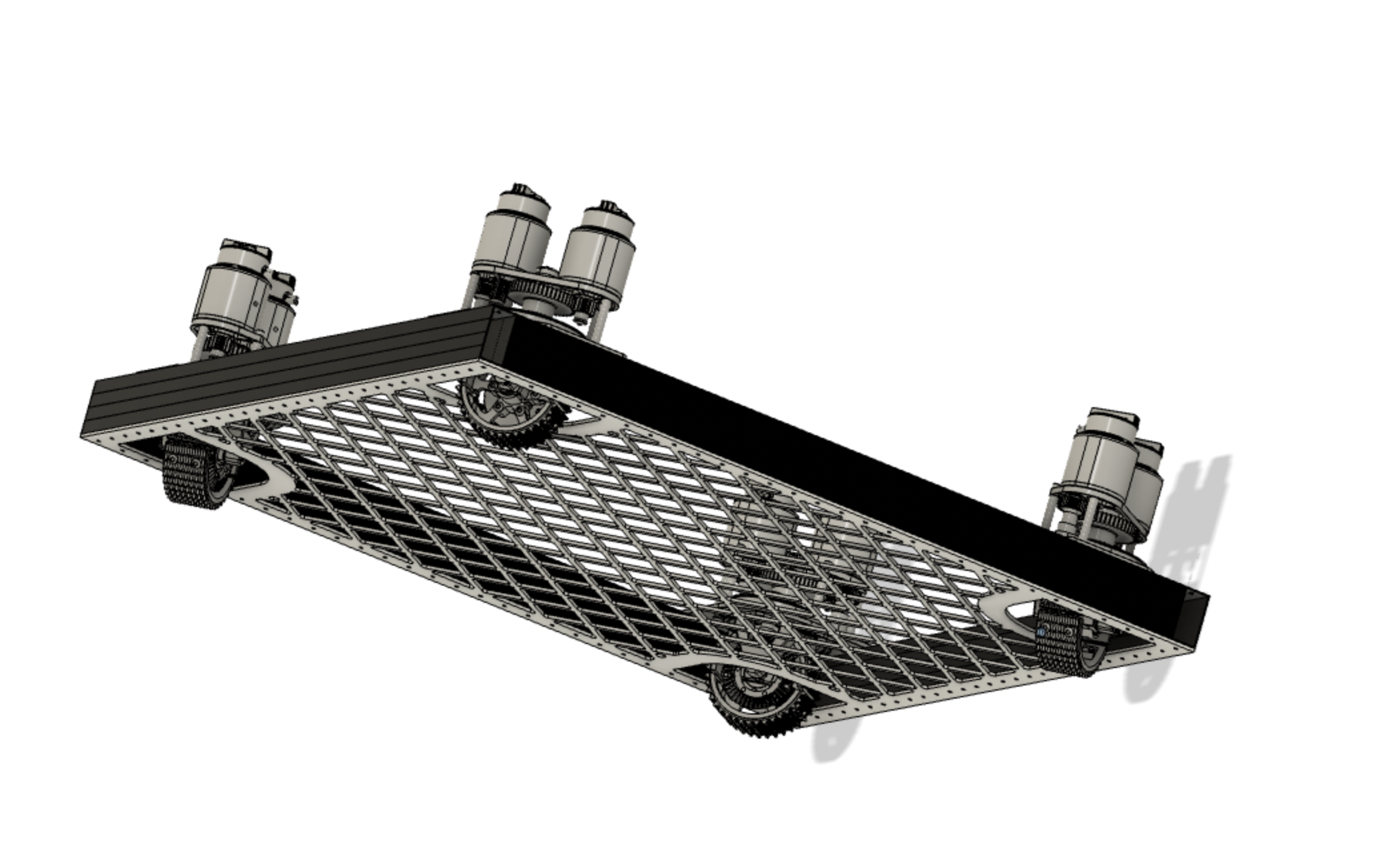

Well not necessarily need more than 1 wheel on each side. You can have a 4 wheel drive like how swerve is. This is the cad of my team’s this year drive train. With x drive you would just put a wheels on 45 degree on all 4 corners and direct drive them with planetary gearbox.
with omni wheels on 45 degrees you wont be able to move forward and to the right and left, it is not swerve, you will only be able to move in 45 degrees which will be very hard to drive
It takes up a lot of robot real estate and gets easily pushed (like - easier than mecanum) under defense. It also doesn’t have a lot of COTS solutions like mecanum, this would require a custom drivetrain. That is why it is unpopular.
This behaves exactly the same way a mecanum drive would behave, under ideal conditions. If you are “losing speed and torque” with a mecanum drive, then your wheels are slipping and you have to address that to get proper performance (e.g. with speed control, more wheels, etc)
All of those problems happen to X-shaped omni drives at full scale, and more, plus they have significant issues with climbing up over terrain. At this point you could almost argue a swerve drive is less work.
