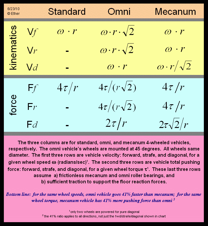

So what I’m seeing is that if you gear down your omni drive by a factor of sqrt(2), you will have the exact same kinematics and force of a mecanum drive. Interesting. They should behave very similarly.
Not quite; look at how the speeds and forces vary by direction.
All the kinematics are the same if you divide the omni by sqrt(2).
All the forces are the same if you multiply the omni by sqrt(2).
Admittedly, I’m sure there’s other practical differences between the drivetrains. But just based on those equations they look like the same drivetrain with one geared faster.
Ah yeah, my bad, I misread the diagonal column.
In practice, fully-weighted X-drive does not actually reach that full speed due to roller friction. The performance of all of these drives once you take friction into account is…rather different.
