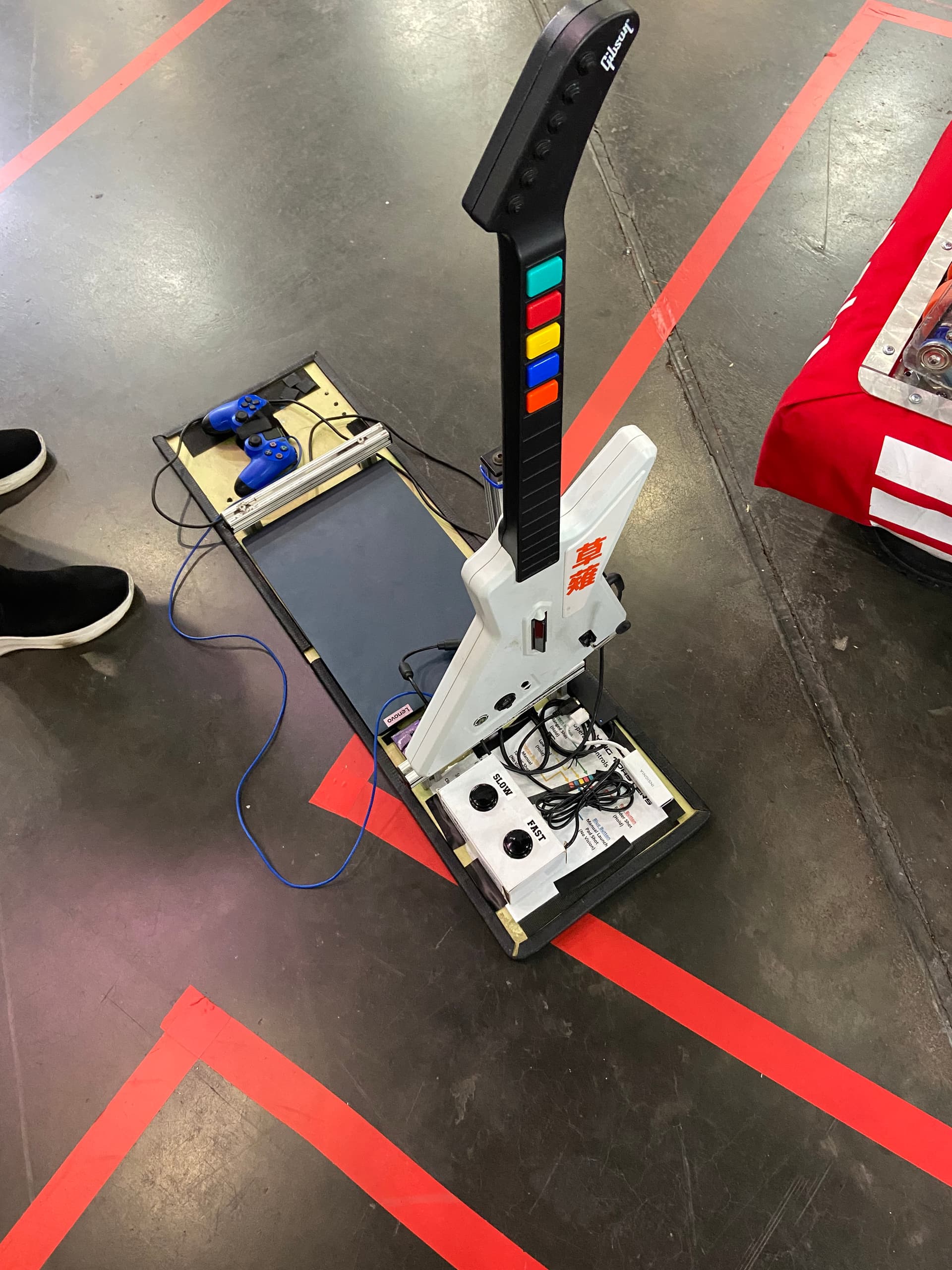

I really wish I could point you in the right direction on how to do this, or even tell you what team this was (because I absolutely don’t remember) but I saw this this at 2022 Houston Champs, so just know it can be done
The flying toasters team 3641 used on before
