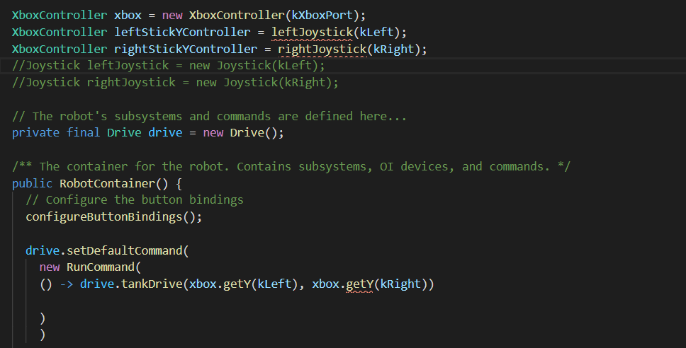

Trying to create a tankdrive in the Container. Having troubles getting left stick to control left side and right stick controlling right. Here’s the code for the container:

Are you driving with an XBox controller or two joysticks? You have both created in your code; the RunCommand is using the XBox controller (e.g. xbox.getY()), not the two joysticks (e.g. leftJoystick.getY() and rightJoystick.getY()).
The call to tankDrive doesn’t look correct, typically it would take two arguments, e.g. drive.tankDrive(leftJoystick.getY(), rightJoystick.getY()), but you’re only passing one. Does this code compile? I’m wondering what your Drive.tankDrive() function looks like.

You’re going to want your command to look something like this then:
drive.setDefaultCommand(
  new RunCommand(
    () -> drive.tankDrive(xbox.getY(kLeft), xbox.getY(kRight))
You don’t need the two additional XboxController construction calls at the top–all you need is the one XboxController variable named “xbox”.
How can I resolve the second getY?
Click on getY then click on the light bulb that appears. You should have an option to fix it there. If not it should be getY(GenericHID.Hand.kRight)
Could you show us the error in this line?
It’s probably an import as jdaming said, but it can also be just a vs code “bug”. So, if it’s not a import problem, you can try reload your vs code.
got it fixed! it was in my constants
Got an error when I deployed the code, but the build was successful.
