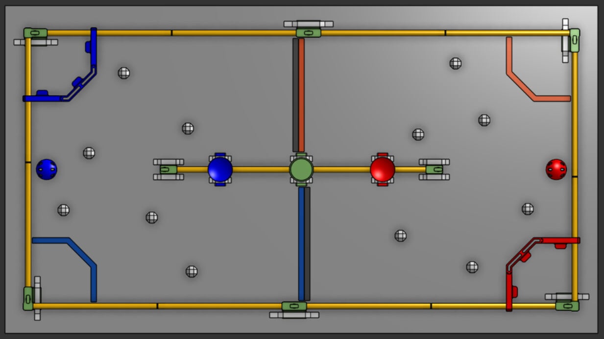

Detailed Field Build Guide
This field build guide is a step by step guide to assemble the field. Also this gives the dimensions for the filed elements, and tape.
Field Improvements

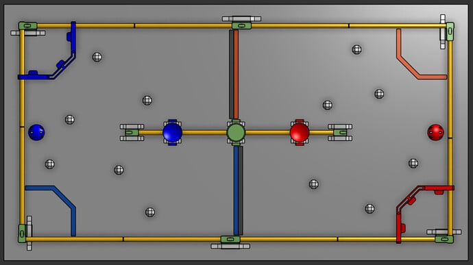

When printing the original files, i noticed there where some inconsistencies with the CAD provided from XRP, a missing file from Printables, and a needed improvement to the high goal.
First the CAD file had all the tubes for the field boundary as 25.5, where as AndyMark is selling them as 24.5. I corrected it in the modified version of there original CAD.

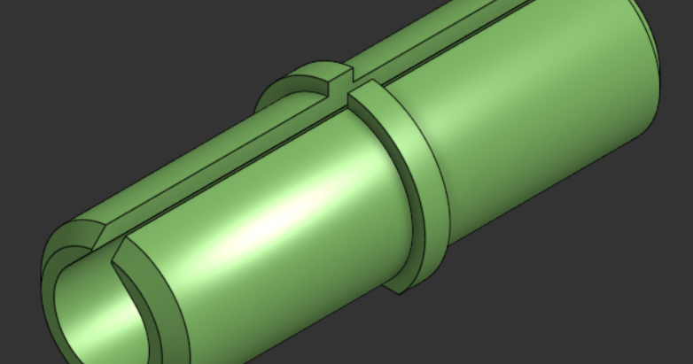

Second there is a missing file they forgot to upload, and that allows the boundary pipes to connect together. I also made it slightly longer to better support the tubes.

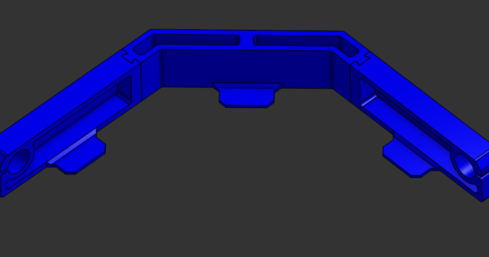

The high goal that they have on Printables was very loose when each section was connected together. Also with it essentially a boundary of sorts, it needed more support. I adjusted the connection areas, and added some tabs to use tape to attach it to the floor.

Updated Field CAD:
Extended Pipe Connector Download:
Improved High Goal Download:
This is awesome!
and good feedback… The field boundary and tube extenders where importnat and quick fixes on the XRP OnShape and Printables.
