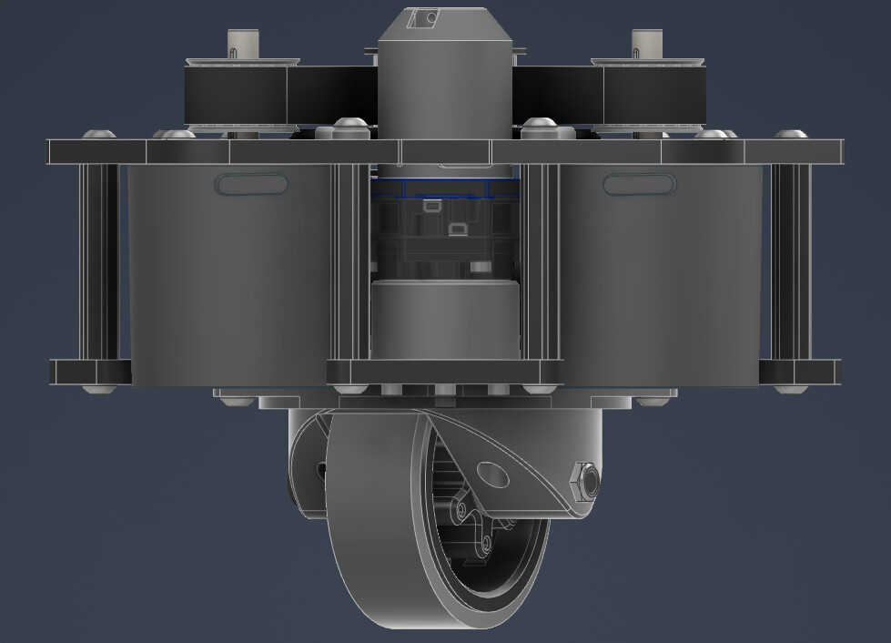

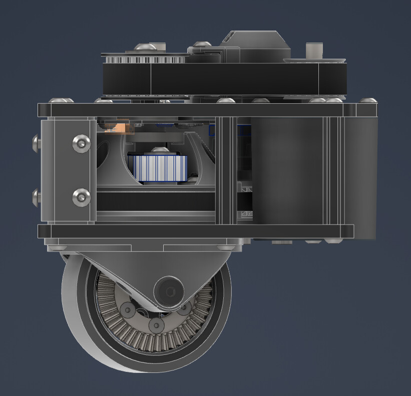

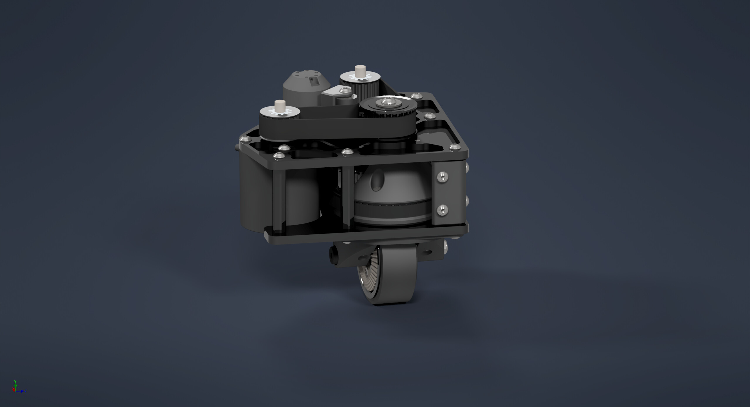

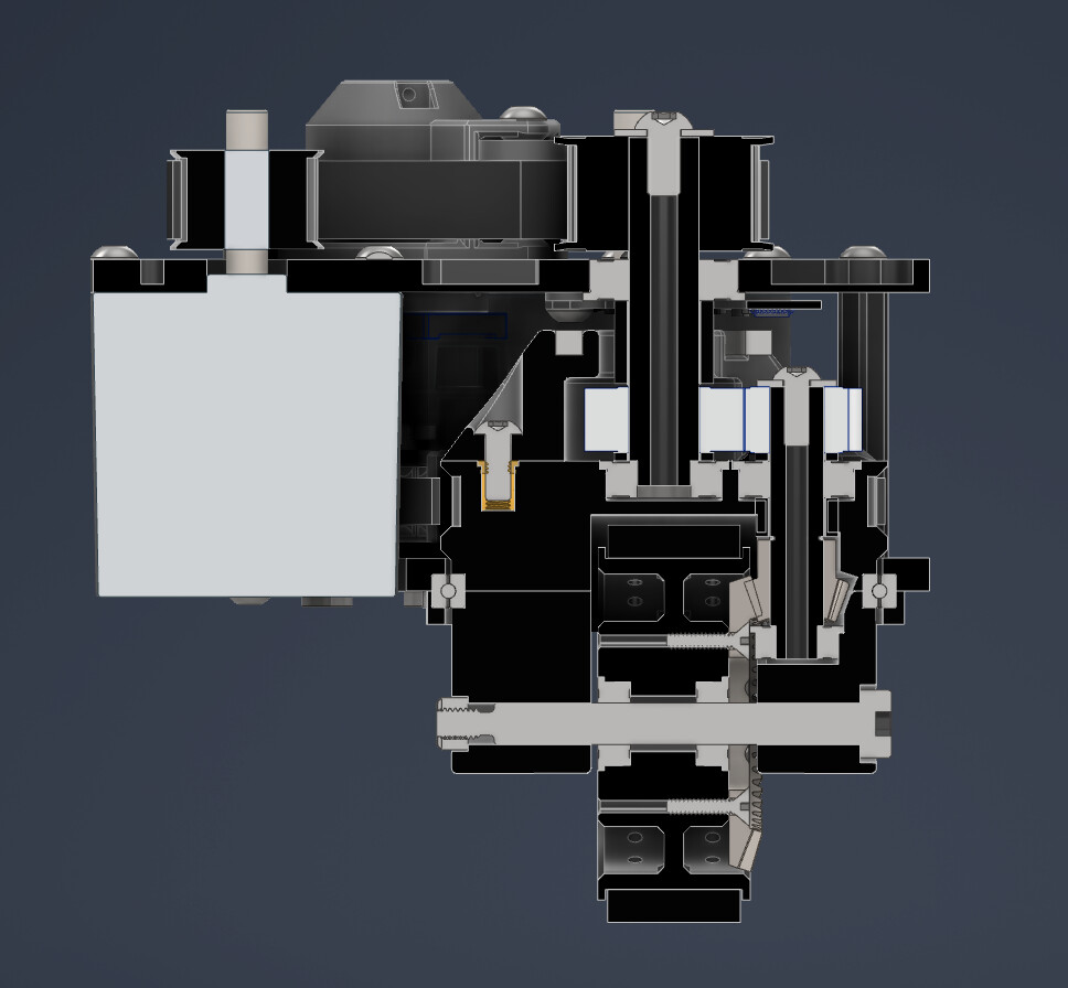

YACDS 2: 2x drive for 2x... something
2 drive motors, because I’m using this to cad a triangle minibot and wanted to go zoooom.

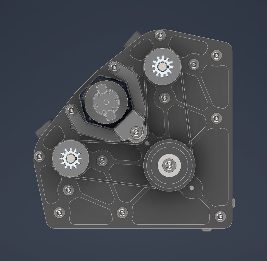

I’m a bit worried about the very small amount of wrap on the driving pulley - does anyone have anecdotal evidence to back up something similar?
Drive gearing is very aggressive - 3.27:1, for a free speed of 22.7 ft/s. Again, this is for a minibot, so this is intentional. Without too much editing this could definitely be turned down, if anyone wanted to use this on an actual bot for some reason.
Steering gearing is a 1 stage UP followed by 10:52 belt, for a ratio from 15.03:1 to 27.2:1. Assuming a 5:1 UP stage is used, this is a bit on the aggressive side but reasonable, according to the 30:1 that tends to be recommended.
Weight according to Inventor is around 5.25 pounds, with weight of 3dp parts from Eiger.
Total print time (with everything Markforged) is 39 hours and cost is $38.86.
(actual print time may vary - for this estimate I used default settings on every part except the magnet holder, which had minimum infill set)
The UP output is once again replaced with a 3dp part to reduce part count and mount the pulley closer to the face of the UP. Still working on getting actual data on maximum load for that, but according to @Ryan_Dognaux if the spline is printed with a 0.003 offset from the REV cad, “it doesn’t easily push on but light arbor press seems to work.”
Inspiration mainly taken from here (if it wasn’t obvious)
CAD is available here

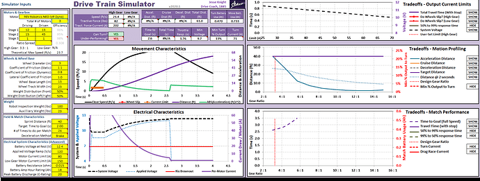

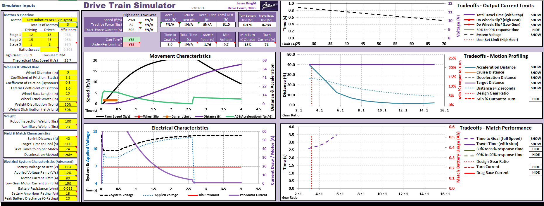

This is really awesome looking! I especially love the 3D printed motor pulleys-over-gears trick. But I think you might be solving a problem that doesn’t exist? If you are indeed making a lightweight demo bot (< 100 lb?), you are going to be traction and/or current limited whether you use 3, 4 or 6 motors. Punching some numbers into the ILITE drivetrain simulator, with 6 motors (assuming 3 modules) geared 3.3:1, and a current limit of 40A per motor (240A total to avoid brownout) I get 2.7s for a 40ft sprint (which is as long a sprint as you’d ever need in FRC):
[edited to fix copy-paste error]

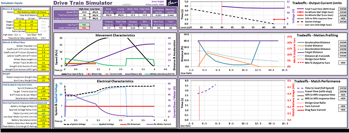

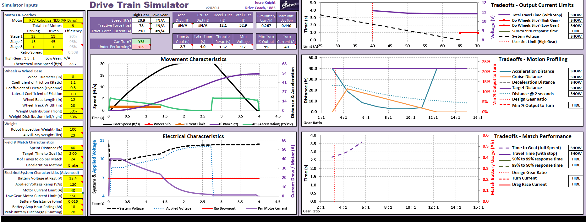

With 3 motors, a current limit of 80A per motor (same 240A total), geared the same, I get 2.6s for the same sprint.
Unless you plan to use this bot for longer sprints outside an FRC field, the extra 2 or 3 motors may not be worth the cost. OTOH, continuous peaks of 80A may be enough to overheat the NEOs, so check that before you take my advice :slight_smile:

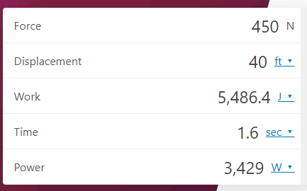

I was curious, so I checked to see what the “perfect” amount of power would be to accelerate 100lbm at the traction limit (~1g) for ~40 ft (~1.6 s). The answer is 3.4kW, or about 10 Neos / Falcons / CIMS running flat out:
image image
This is a good illustration of the difference between an “ideal” calculation, and a more complicated simulation like ILITE, which shows how the system losses due to motor efficiency, electrical resistance, and gearing friction prevent you from ever putting those extra motors to much use.

I personally think your belt set up will work, but what is stopping you from just running 2 9mm belts rather than 1 long 15mm belt? I think a 9mm belt is appropriate for a neo output, but I could be wrong.
Also, if you want to lower the ratio a bit, we have used WCP 8mm bore pulleys with pretty good success: WCP - HTD Timing Pulleys. This would let you get away with a smaller input pulley.
