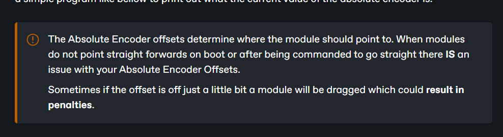

Hi everyone, my team and I just got swerve for this year and we found the marveleous YAGSL code. The thing is that I’m having problems configuring the Absolute Encoder Offset of all of my modules, the modules do not point straight forwards even tho i already put an offset value, for real it doesn’t even change lol, so i looked up at the YAGSL Documents and found out this.
