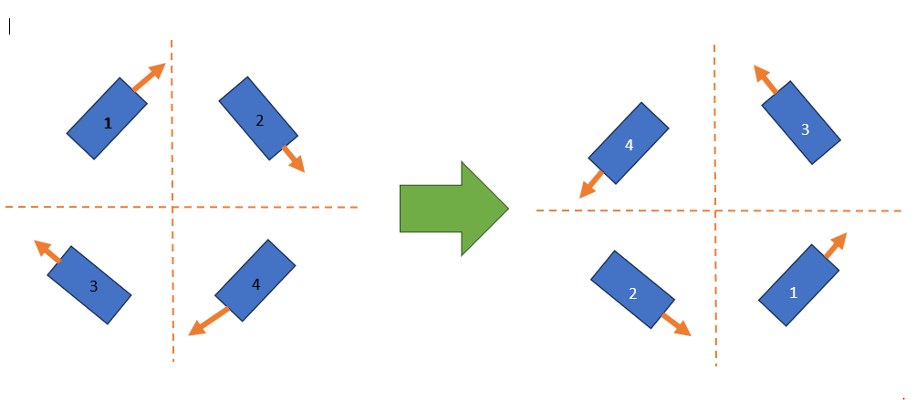

maybe this is a result of incorrect module location configuration. :thinking:
Before I made the edit to the YAGSL library, when I manually put in a positive chassis rotation speed the robot rotated CW. Path planner would have expected that to go CCW. My code is here if you want to take a look at my YAGSL config
Have you tried following this page of docs? (Its new)
I think somewhere after step 4 it may work without this patch.
If you flip the modules around (think backwards as forwards and left as right) CW rotation becomes CCW rotation when attempting to rotate in place.
I probably spend about a dozen hours flipping settings in my YAGSL config over the past week in an attempt to solve this issue, nothing worked. I’ll give some of those steps a try to see if that makes a difference rather than the edit I made to the library
Thanks! I would save off your current config and instead of making the change in the library make it in the SwerveSubsystem. Just incase the changes don’t work.
In theory this may be bc your gyro is reading CW+ (somehow) and your motors are doing this bc the locations are incorrect. Flipping them like bellow so your gyro is invertIMU true and swapping ID’s like bellow should work.
