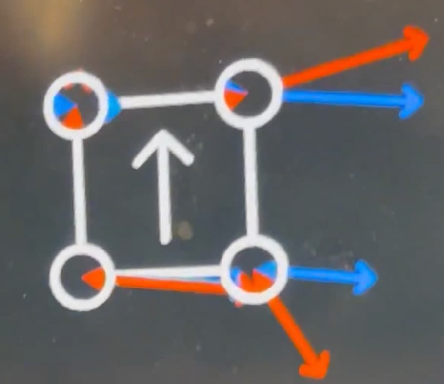

We are using swerve for the first time and attempting to use YAGSL, but seeing wheels not steering when we try to drive them, as well as twitching when they are not moving. We would appreciate guidance on whether we are testing properly (is placing the robot on blocks a valid configuration?), if we just need to tune PID (given the erratic behavior we are seeing, we aren’t sure we are to that step), or if there is something you can identify that we are doing wrong?

The wheels appear to just stop in whichever orientation they were already whenever we try to drive. Looking at Advantage Scope, we see the drive speeds are tracking desired values (including slow speeds for wheels that are perpendicular to the desired direction) but the steering directions are not tracking properly.

In the first one (robot on cart) the driver is commanding full front, then full right, and so on. When the camera zooms into Advantage Scope (blue is desired, red is measured), you will see that the front left wheel is completely perpendicular to the desired direction, but is not attempting to rotate to steer to the desired direction (none of the wheels are changing directions). The other wheels are closer to correct, but they are not changing to redirect to the correct direction. However, you can see that the drive motors are properly commanded: the measured speed of the wheels is matching the desired speed. Also the code seems to be properly calculating desired speeds: wheels that are more perpendicular to the desired direction are desired to go slower, while wheels more inline with the desired direction are commanded faster.
The second video shows the robot on the carpet and we are seeing a similar effect (as it drives toward the camera, you can see that one wheel is almost perpendicular to the motion the robot is going).
It really seems like when the robot is driven (joystick pressed in a direction), the steering motors just stop. Also, as far as the jitter when the robot is not being driven (joystick straight up, or in deadband) it seems the wheels are trying to correct for odometry: when we start up the robot and go to teleop the robot is perfectly still, but if the wheels turn (even hand pushing the tread to rotate them), the wheel reverses from the motion we gave it and then it oscillates and then we start to see the steering motors begin to get involved. Doing this (hand pushing a wheel as though it has driven a distance) with only one wheel results in just that one module doing this while the other three remain sitting still.
