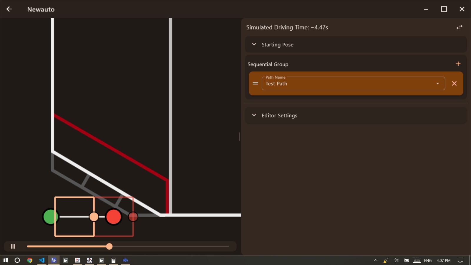

Hi, this is our first time using Pathplanner ( swerve is configured with YAGSL). We had created a basic path moving straight forward. But when it does move this is what happens
Below shown is the path we used

  1. When the swerve is kept on a trolley. The wheels appear to move perfectly straight and even the path planner recognises the path being completed accurately.However when we kept the swerve on the floor its slowly starts spiralling out of control (edited)
Pathplanner Issues - Google Drive (video)
  1. The robot always moves backwards whereas the path planner believes it to move forward however in turning the robot and path planner move CW.
Note:- PID is not tuned and could be causing issues.
Are your wheels moving in the correct direction? Have you tested direct angle control?
i dont understand what you mean by wheels in the same direction, however during teleop the code works perfectly with angular velocity control (not direct angle control haven’t tested too)
In auton the angular turning of the robot is as commanded (CW = CW) but translation seems to reversed
I said “correct” direction not “same”. The difference is very important here. This sounds like when your wheels are running with positive dutycycle they cause the robot to turn CW, which is an easy fix.
it seems to spiral out of the control which could be beause it is trying to correct angular error and the correction is in the direction of the error, so this could be the problem.
You have to test the 8 steps. You could do this by running with pathplanner but that is more tedious. I recommend using this drive function to test the eight steps.
https://yagsl.gitbook.io/yagsl/configuring-yagsl/the-eight-steps
Alright, thanks, we’ll try : )
Also, ou CANcoders keep changing their offsets a lot, everytime we change the offset it works for a bit then gets slightly misaligned.
This sounds like the glue/loctite holding your magnets in place is slipping, please check and redo them according to the module assembly documentation. This will cause an issue during any match you play and maybe even your autonomous.
We tested it today. It works, turns out the drive motors were inverted. : )
