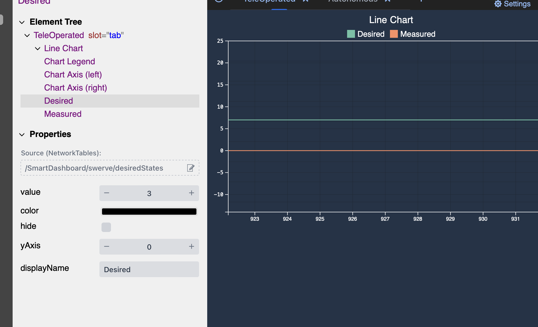

If we can’t get REV to work, is it possible to use FRC Web Components to tune the swerves? I have tried this but with no luck. I have desired states and measured states as the two data points, but the lines don’t move either. I would really appreciate it if someone could give a detailed description of how they tune their swerve PIDs. Thank you!

Tuning on the ground is best, for the swerve widget i only have experience with FRC Web Components so i will lean there. The end goal is to get the blue lines (measured velocity) to match up with the red line (desired velocity) as much as possible. I would start with the defaults from the main example project or some known working pidf values and go from there. Move the robot around on the carpet if they are close but not quite good enough, but if they are wayyy to far off to be dangerous don’t test on the carpet.
Using the blue lines as the measured velocities base all of your tuning decisions off of that. If it constantly oscilates to overshoot increase D or decrease P. I would advise you to look at WPILib’s documentation on tuning and reference the chart on mine while youre doing it.
