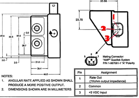

I can’t find the datasheet for the yaw sensor, can someone please tell me which is vdc, common, and output? Looking at the connector with the bolt holes down, the sticker on the left.

i am currently looking for the exact same thing.
If i find it i’ll post it.
i know that according to the manual from top to bottom its CBA
C=Analog Input ##
B=Ground
A=+5vdc
but i dont know what orientation that goes in.
there is a datasheet that came with the sensor that has it on it.

Yes, and I lost it… I’m hopeing someone can tell me which pin is which.
Greg
sorry i cant get to a scanner otherwise i would scan it and post it.
Look, i know everything about it except which of the three pins go to what.
Fill in the blanks:
Pin 1: _____
Pin 2: Ground
Pin 3: ______
What are the blanks?
here is a pic.
Thanks a bunch!
