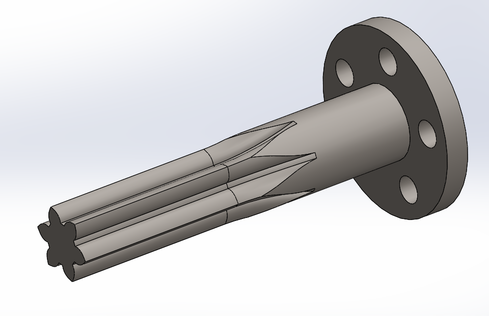

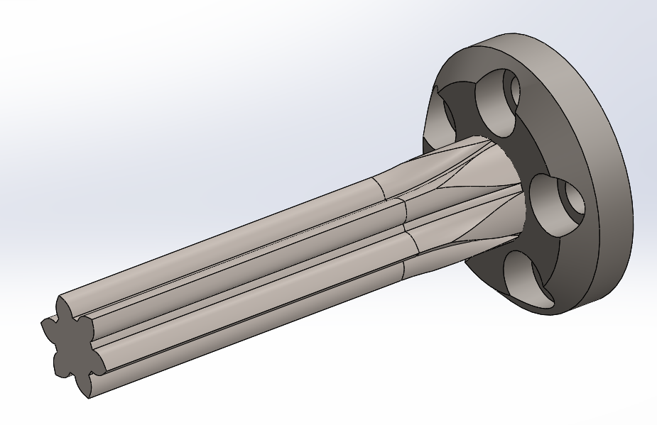

This is a (mostly silly) concept for a 6T 32DP gear cut into the 8mm Falcon shaft. Included are two designs: one for a 2-part pinion which has the gear teeth running the full length of the shaft, and one for a 1-part pinion with a shorter usable gear width.
The one-part shaft is similar to the Thriftybot 8mm round shafts. However, the diameter of a 32DP gear cutter necessarly means that the usable gear length has to be shorter, so that the gear cutter can clear the hub.
The two-part shaft has a separate hub piece (here, the same piece as on the base Falcon motors) so that the gear can run the full length of the shaft.

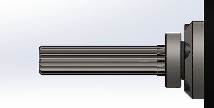

The current design constraint here is that the assembly (as currently put together) needs to be able to fit through the nose bearing of the Falcon motor, so the OD of the pinion had to be less than 8mm ~= 5/16". If you make it an 8t gear, the pinion is cut down a tad and looks rather wonky.
You could assemble the two-part pinion in place, with a bearing permanently retained between the shaft and hub, but that would likely make assembly difficult, especially since it looks like the nose bearing is pressed into the face plate of the motor.

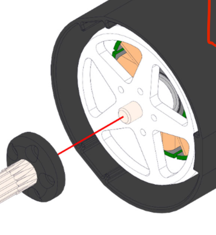

Slightly unrelated, looking at these CAD models, is there no boss to center the shaft? Just the mounting screws? We don’t have a Falcon, so I haven’t taken one apart yet. With no competitions to go to this year I haven’t seen one in person either.
The Falcons don’t use a boss to center the shaft. They are located using a nose bearing on the front of the motor as well as the 5 mounting screws.
(Edit, this is incorrect; see Mike Corsetto’s comment below)

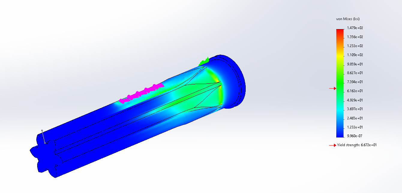

Doing some hand calculation: Letting t (tooth width) = 0.07", h (tooth height) = 0.068", b (gear face width) = 1". I’m not using the same loads I computed earlier as they were for a lever on the exact pitch diameter, i.e. with radius 6/2/32" = 0.094", but the distance from the center axis to the outer tip of the tooth is actually 0.151". This leads to a tangential load Ft of 220lb at stall.
Using the equation calculated here:
F_t=b*t^2*\frac{\sigma_b}{6h}
\sigma_b = \frac{6F_t h}{bt^2}
Plugging in our numbers, we get \sigma_b = 18 ksi. 4140 steel has a yield stress of approximately 60-100 ksi (depending on heat treatment), so it’s within load concerns here. Of course, this is a pretty rough approximation, and I would expect to see accelerated tooth wear on this pinion.
Using a value of b equal to the engaged portion of the gear, though, is much more concerning, since
Running the FEA, however, results in sub-optimal results. While the tooth does not seem to separate from the shaft, there are high stress points exceeding yield incurred across the root of the shaft and in between the teeth. These are additionally in optimal conditions, which means that it only gets worse from there on out. (Note: since SolidWorks doesn’t have a builtin material for 4140 steel, I used 4130, which isn’t quite it but pretty close)
Current limiting can be something of a saving grace here. With a 60A current limit, the tangential force on the tooth tip is 51 lb. This leads to a new approximated stress of 4.2 ksi, which is acceptable.
Re-running the FEA, using a 60A current limit on the motor:
The stress in the shaft is well within the yield stress when under a 60A current limit. Good news, then - the shaft could be usable in applications which don’t require all the torque of a Falcon 500. However, aggressive current limiting and voltage ramping would be required to avoid gear failure.

There is a locating pin on the front the magnet bell, which holds the shaft concentric to the bell. Page 3 of the shaft swap user manual shows this.
Best,
-Mike
Thanks for the info. Looks like that would need to be added.
