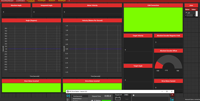

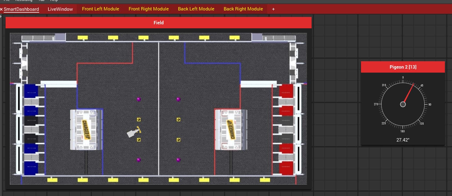

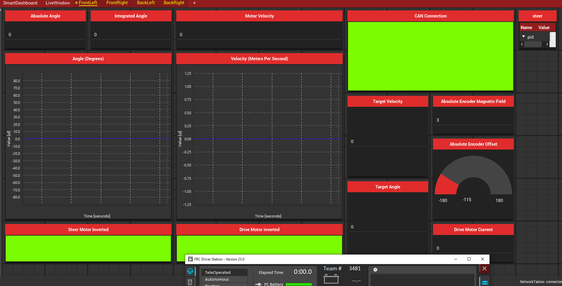

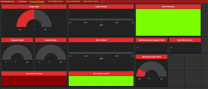

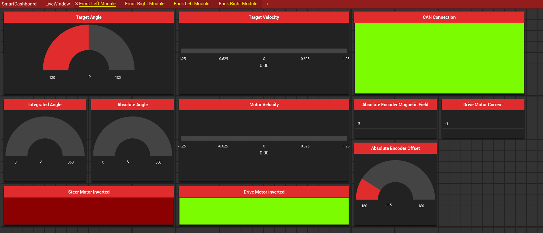

The library creates it’s own dashboard (which can be optionnaly updated in a periodic function with varying degrees of verbosity) that helps with tuning and debugging.
There is support for both Falcon’s and Neo’s WITH THE SAME CODE BASE alongside support for multiple different encoders both integrated, on the CAN bus with or without a CANivore, or directly from the roboRIO.
This implementation utilizes SecondOrderKinematics in an attempt to provide a better control system for the Swerve Drive. In addition to some state-space modeling for position estimation.

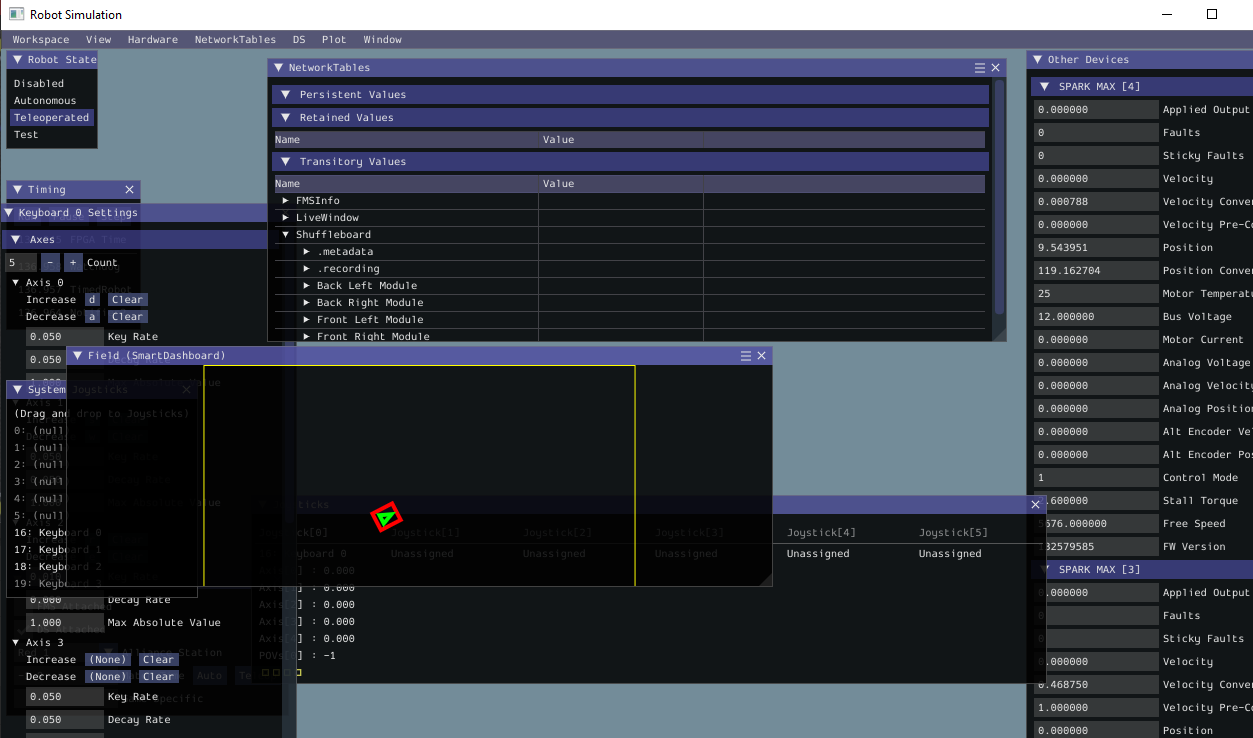

There is complete support for simulation with NEO’s however falcons require more testing/development. The configuration should be very easy for any team to use and robust enough to be applicable to most Swerve Drive’s.
