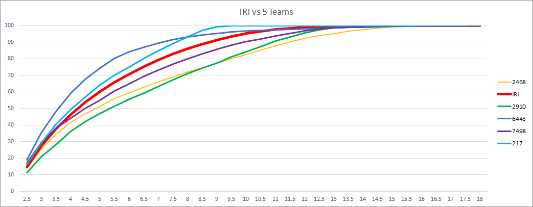

I’ll refer only to 2910,2468 who were the “zippiest” robots at IRI in my opinion.
(7498 had the potential mechanically, but their driving style didn’t match my criteria).
If we’ll compare their graphs (who looks pretty similar), we can see that 2910 top speed is lower than 2468’s, but that 2468 spends more time in low speed.
The data over here supports my saying, as we can see that 2910 spent less time than 2468 on speed that lower than 2 ft/sec (that’s true up to ~8 ft/sec as we can see from the chart).
The important thing here is - cycle time saved is cycle time saved. If you aren’t the absolute fastest at full speed, but your careful precise driving saves a second or two lining up, you’ve more than made up for it.
It shows in that 1477 vs 610 video above - 1477 does faster full field sprints but spends some time overshooting and backing up, aligning, etc. that 610 does not.

Haha that’s all good, as you can see from @Matt_Boehm_329 graphs, you were above the average in IRI for driving speed.
