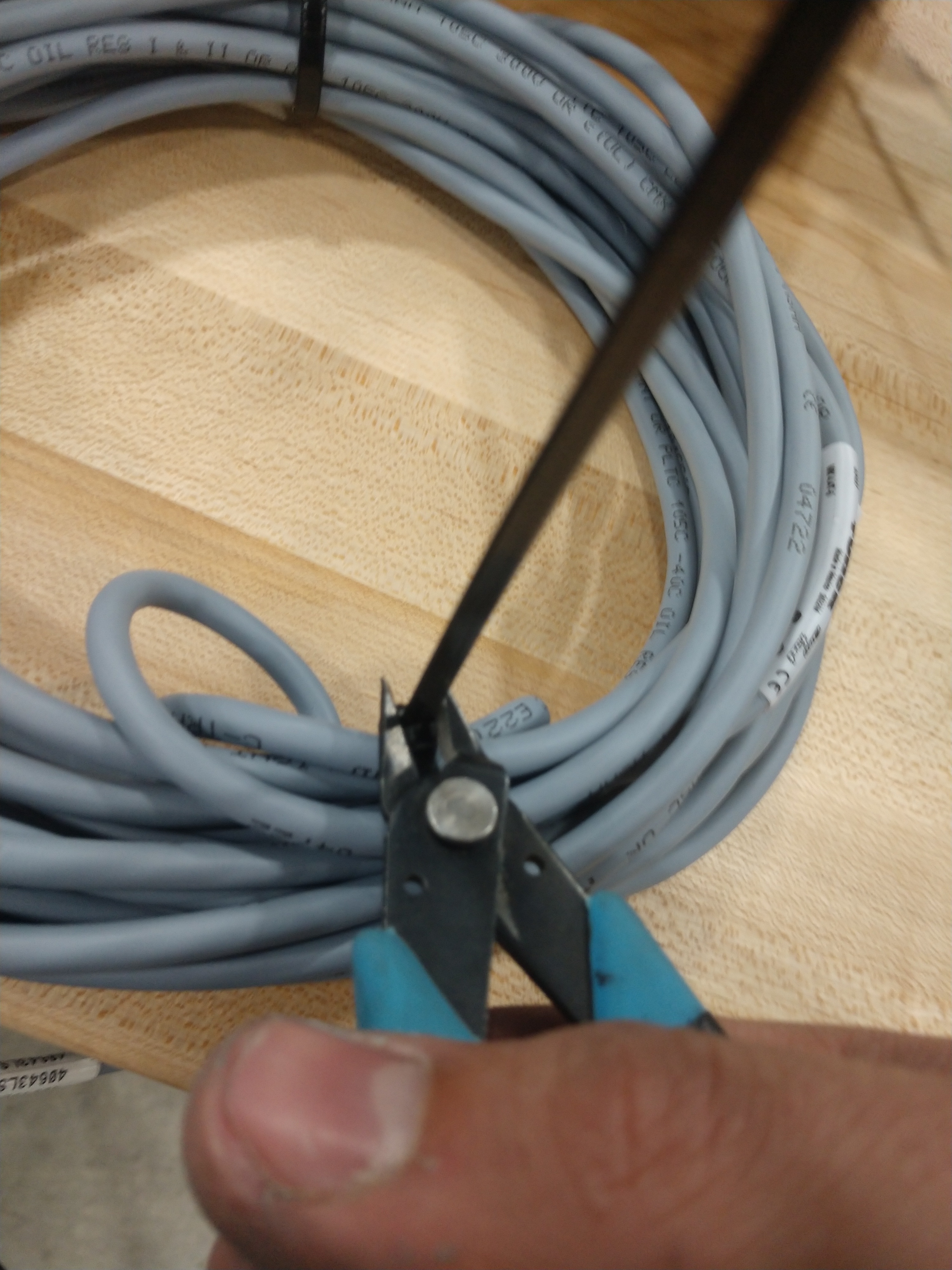

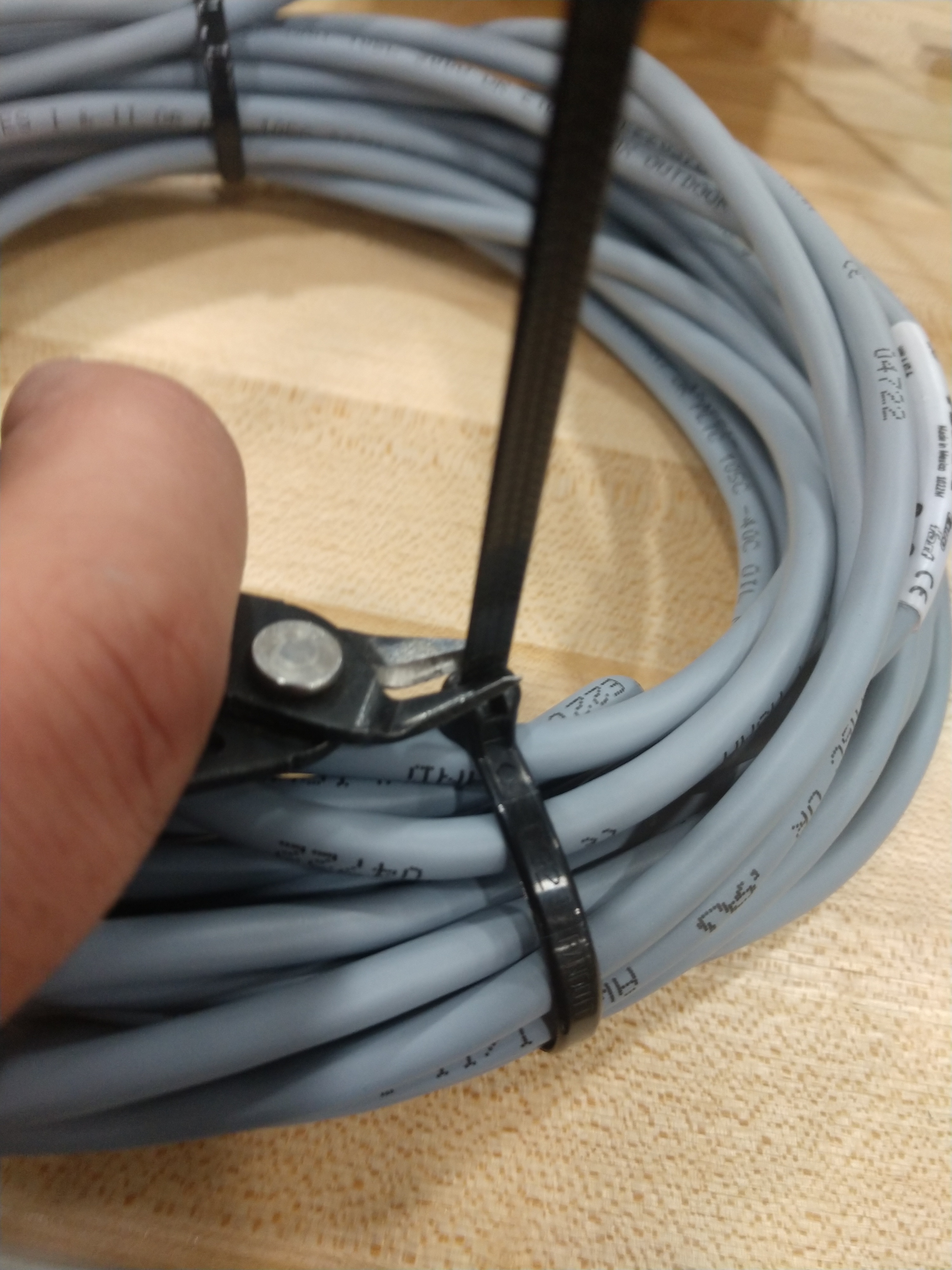

I just use these, and instead of cutting it parallel with the cutters, I cut it perpendicular (but still flush against the zip tie) and it tends to not be sharp.
Can you post a photo of this?

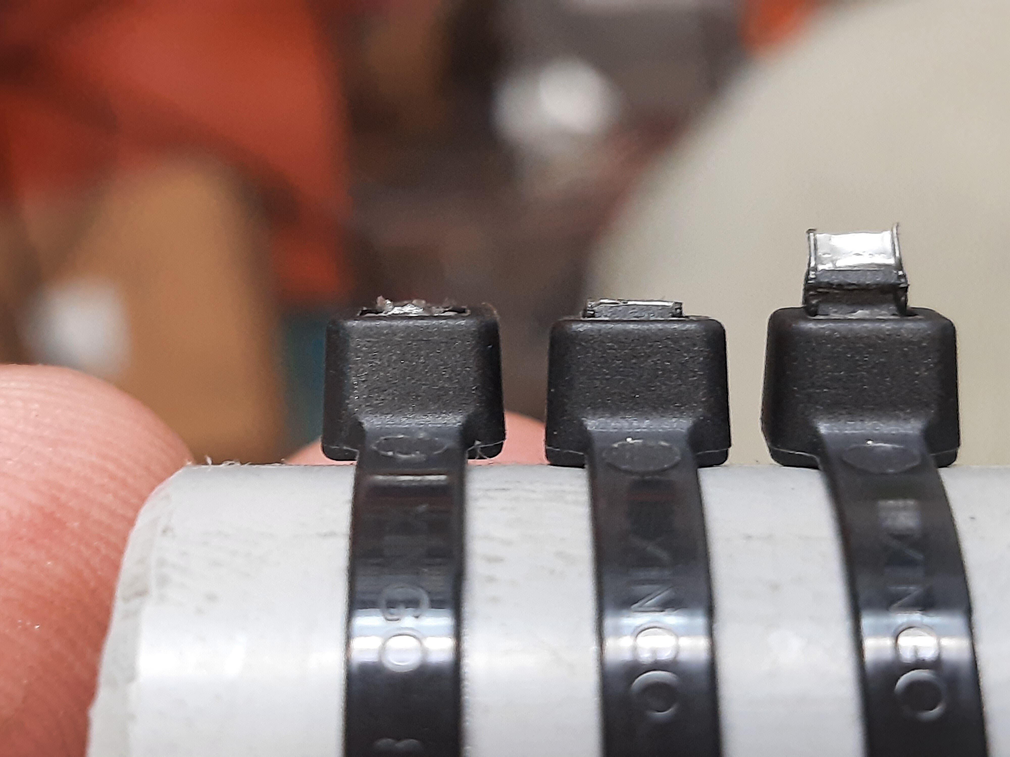

And… test data! On the right is a $20 Amazon tool. Middle is the cheap McMaster tool. Left is the expensive McMaster tool, a Thomas&Betts ERG50. Middle and left I’d call an actual flush cut!! Right, not so much.

I’mma need a wrist test on that one. Will investigate the ERG50 though…
I felt it carefully. I wasn’t willing to Blood sacrifice for it, though!
The ERG50 is, um, pricey.

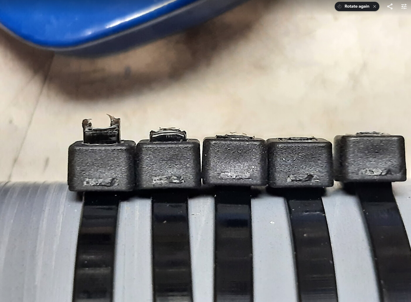

Creates sharper cuts:
Creates smoother cuts:
I lived my whole life thinking it would create sharper cuts the second way but I did it cuz I had to cut a zip tie in a tough position at work and my life has been changed lol

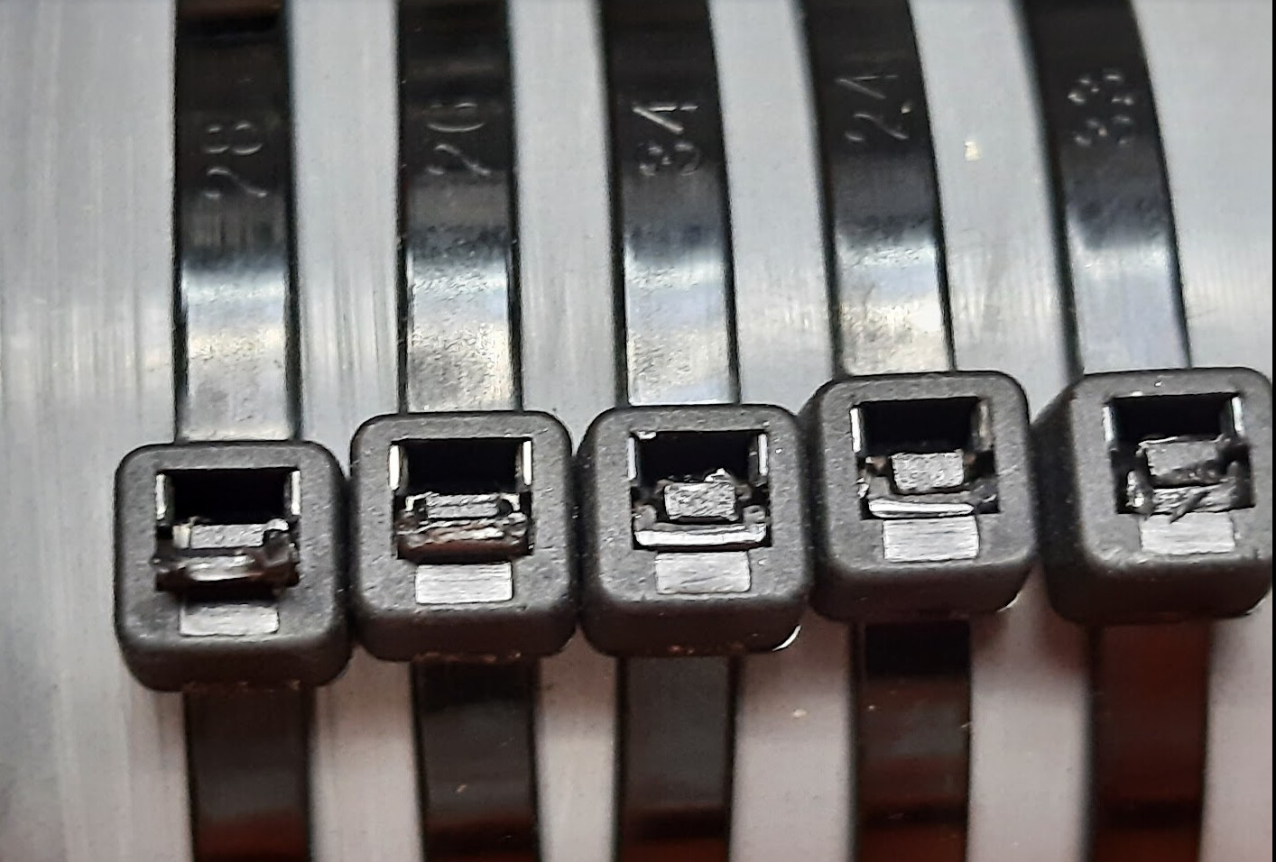

Another round of zip-tie shootout. The gold standard is stegg85’s method on the right.

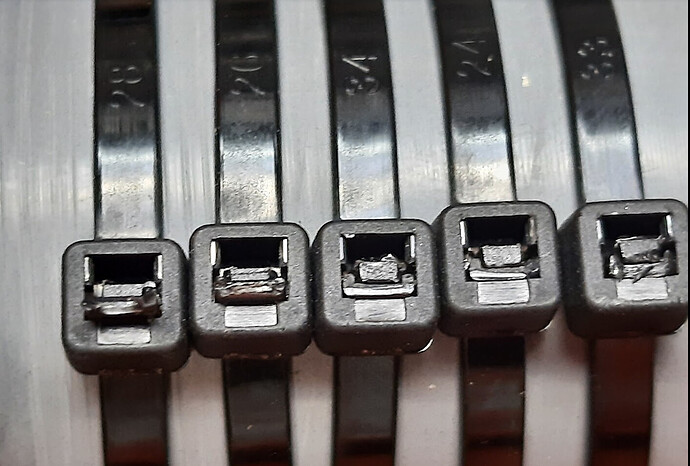

Top view of the cuts:

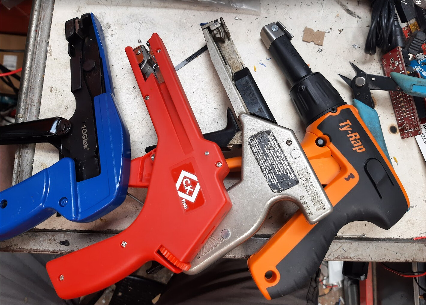

And the contenders :slight_smile: Cheap-O off Amazon, CK 95003 from McMaster, Panduit GS2B, and Ty-Rap ERG50. The CK is the cheapest that does a solid job. The Panduits are available on Fleabay for $40-50. NOTE: the tension is important for function! If you have the tension set way too low for your zip-tie, you will get a sticking out end even with the Ty-Rap tool! It really needs to pull, stretch, cut, and allow snap back.

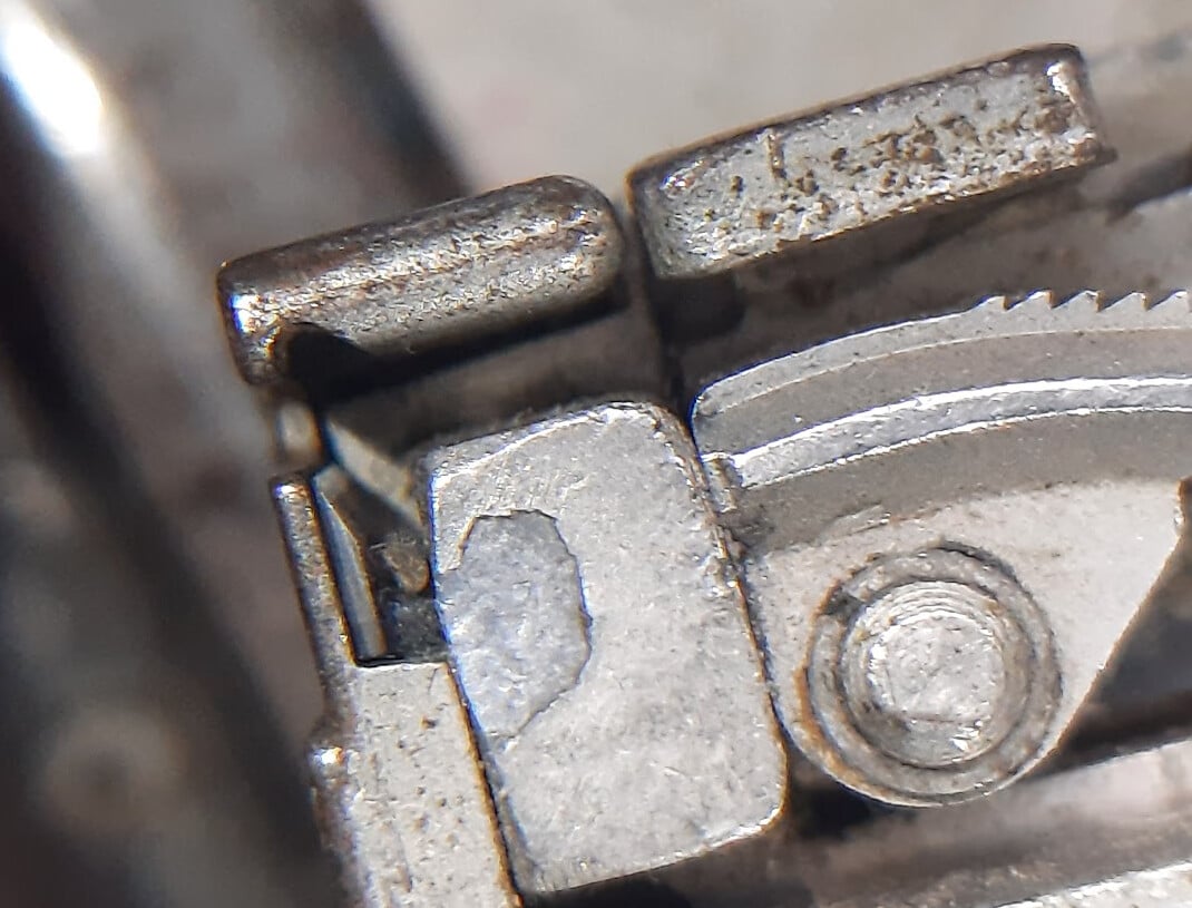

Gratuitous detail shot of the working bits of the Panduit. Note the tiny, sharp, single bevel blade in it. A little grinding on the end could improve its trimming performance further.
