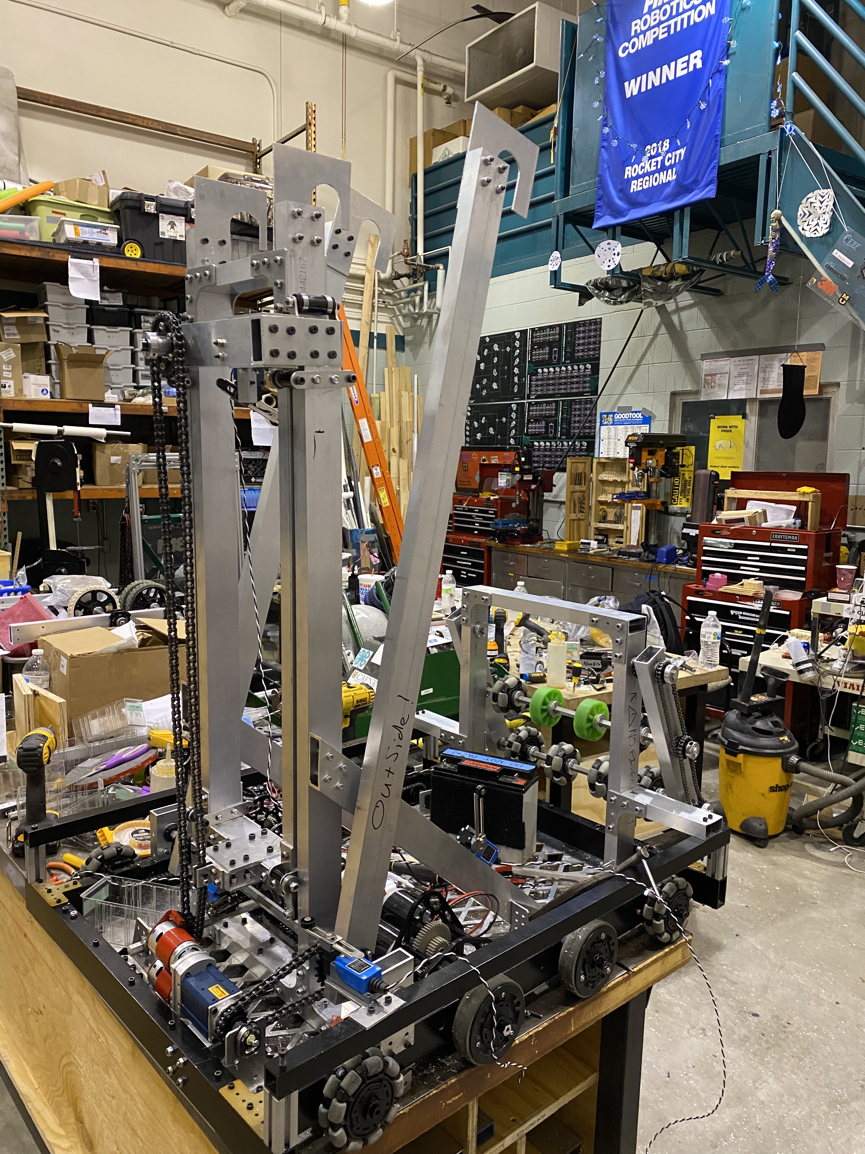

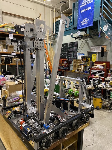

DAY 3
Yesterday we finished fabricating our climber (elevator and rotating arms). However, we do not yet have hangars to test it on. We normally use the field elements of the local FRC team we mentor (army ants). Their parents/mentors building it have not yet gotten to them, so we will help build them tonight to have a proper climber test. Previously, we were going to give up adding a shooter for the sake of time, but we may add one while the hangars are being built.
There will be no day 3 video update as we have no way of testing what we built. As soon as we can test the climb we will upload a day 3/4 showing its success or failure.
Here’s what the bot looks like at the moment:
