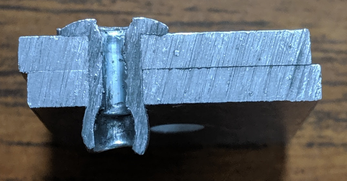

On a 1-inch-wide chassis rail, we have one row of rivet holes down the centerline, spaced 0.5 inches apart. Our gussets also have holes every half-inch. When assembling rails and gussets, we put lay out the rails, put gussets on them, insert rivets into all of the gusset holes, pull all of the rivets, then flip it over and gusset & rivet the backside.

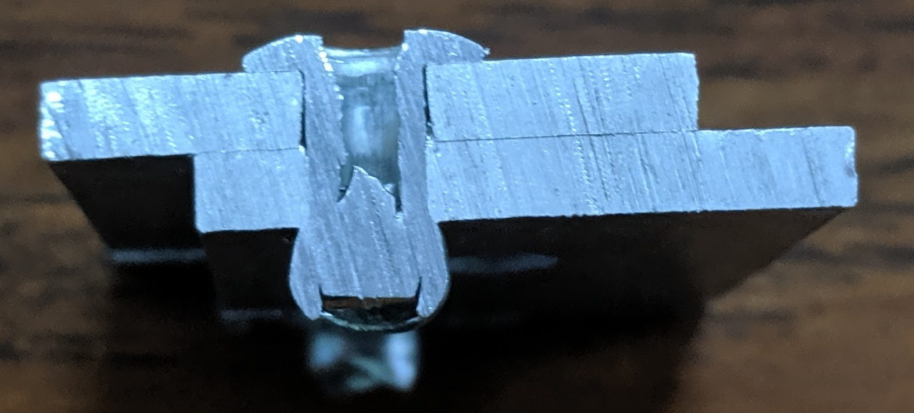

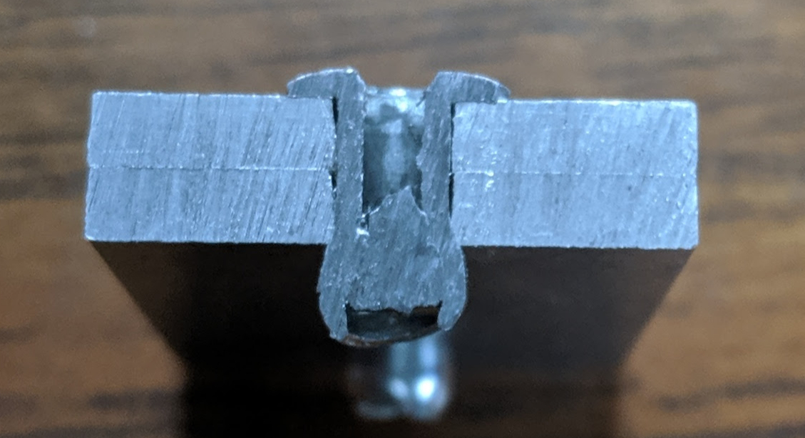

We use a # 11 drill bit ( 0.1910") for rivet holes. This allows the rivets to slide in freely, and also makes it easier to fit # 10 bolts. A 3/16" drill works in a pinch, but has a tight fit, often requiring a small socket and a hammer to push 3/16" rivets into the holes. (Maybe reamed 3/16" holes would fit better?) We also use a 3/16" drill to remove rivets.

AM posted a nice cross section of 3/16" rivets in .201 and .192 holes.
