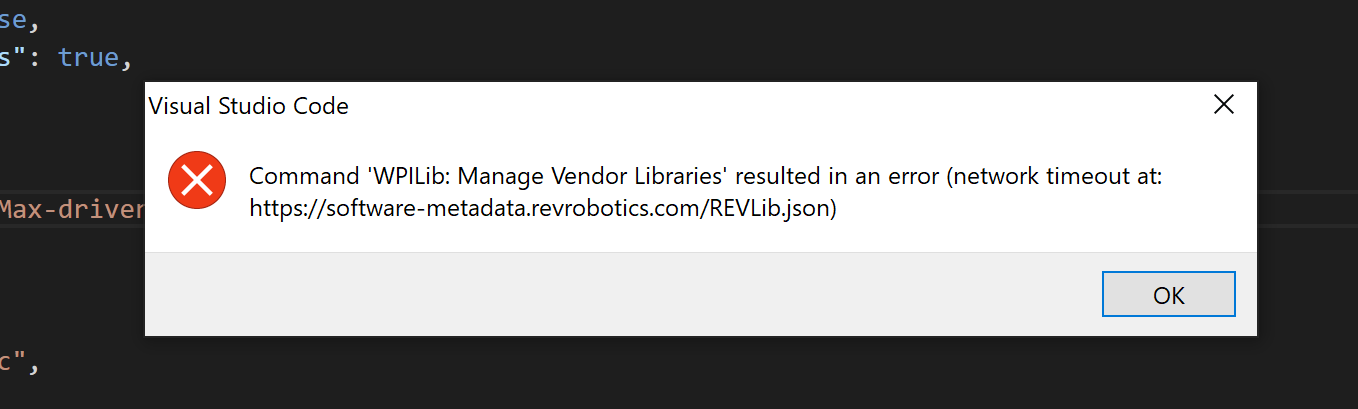

Ive tried to do that but ever time i do it gives me this message
Your school’s network may be blocking it.
You can also try the offline instructions
https://docs.revrobotics.com/sparkmax/software-resources/spark-max-api-information#c++-and-java
Im on my home network rn and its still there so i did it offline. I did this yesterday when I was at school and even with the new vendorDep, it still was throwing the same error…
