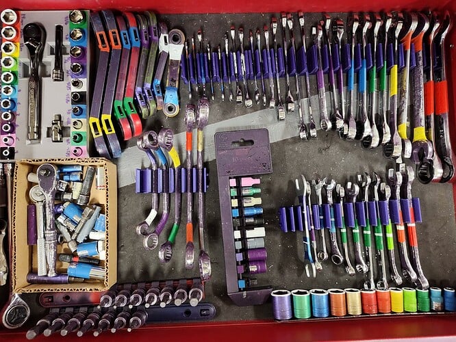

As far as wrenches/screwdrivers are concerned, we color-code. A strip of electrical tape on each is all it takes!
Only issue arises when a color of the physical wrench differs from our designated color system.

Our team color codes for the sizes we use the most that fit together. For example, if we use a size bolt often, the hex alan for that bolt, and the wrench that fits it’s corresponding nut, will have the same color on them. This allows us to quickly find what we need in a build season, and can help out rookies, by just telling them what color they need for something they can find it even if the build room is a little chaotic at times.

We’ve used colored heat shrink and paint markers for color coding Allen key sizes. There are some vendors of Allen keys that color code ‘from the factory’ too.

4336 does the same. Colored Electrical tape. So much easier for students to find a blue allen and blue wrench, than it is to find a 4mm allen and an 8mm wrench.
We also color code our hex keys/T-handles. Mostly with electrical tape.
Blue for 3/16
Red for 5/32
Green for 1/8
When asking for tools its normally a “Blue T” or “Red 90”. Helps a lot with speed of repair especially when working in a 8X8 when walking to the toolbox isn’t possible.
